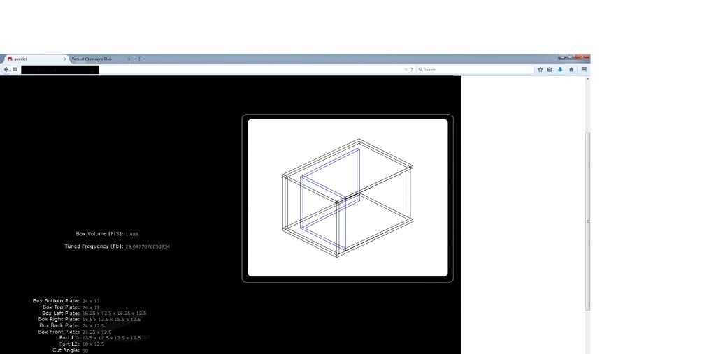

How much with do you have from side to side and from back wall to front seats ?
my truck low kota - Page 9 Empty Re: my truck low kota
Post by NomaOnAir on Tue Jan 20, 2015 10:06 pm
If you have 48" to work with , this would be half of the box , we would basically mirror this box on the other side. This is assuming , your can use these measurements.
my truck low kota - Page 9 Ryanbox
Post by NomaOnAir on Tue Jan 20, 2015 10:18 pm
Top/Bottom - 24 x 17 ( would be 48 x 17 )
Box Left (2) - 16.25 x 12.5 x 16.25 x 12.5
Box right (2) - 15.5 x 12.5 x 15.5 x 12.5
back - 24 x 12.5 ( Would be 48 x 12.5 )
Front - 21.25 x 12.5 ( Would be 42.5 x 12.5 )
Port L1 (2) - 13.5 x 12.5 x 13.5 x 12.5
Port L2 (2) - 18 x 12.5
Post by NomaOnAir on Tue Jan 20, 2015 10:22 pm
So it would be over all.
48" Long
17" Tall (Floor to Roof)
14" wide ( back wall to Seats )
