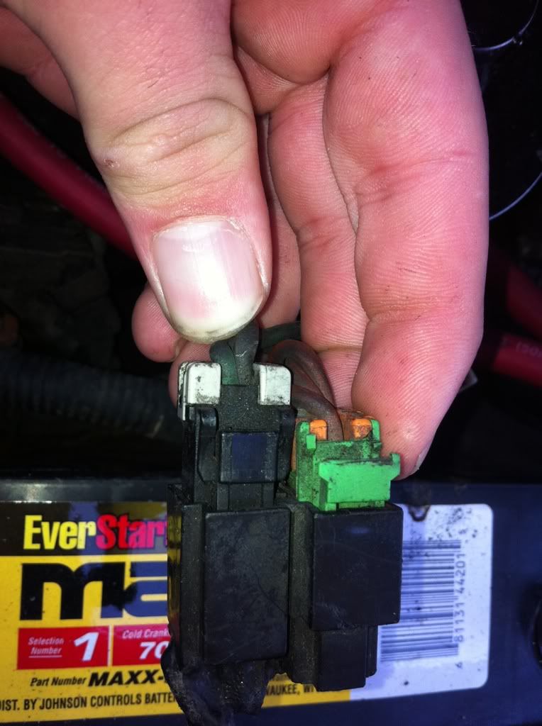

I figured out that I had a blown airline in 2 different spots so I fixed that and know I have a short somewhere, it never fails.

I think both and that prob why my switchbox only works sometimes. The wires on the battery started smoking and now the nothing in the interior works, no radio, ac, heat gauges. I checked all the fuses and they are fine so I not sure.

Need help rewirng and installing valves in Jax Fl - Page 2 Empty Re: Need help rewirng and installing valves in Jax Fl
Post by NomaOnAir on Tue Feb 14, 2012 8:35 pm
I know there is a fusible link right around the battery that is known for going out on our trucks.
Post by IBDRINKEN on Tue Feb 14, 2012 9:42 pm
Is this the fusable link on the battery terminal
Post by NomaOnAir on Tue Feb 14, 2012 10:18 pm
It is one of them , I think it is a dealer only/junkyard part.
Post by IBDRINKEN on Tue Feb 14, 2012 10:21 pm
It was prob the one that was smoking lol
Post by IBDRINKEN on Tue Feb 14, 2012 10:29 pm
Here is a better pic
Need help rewirng and installing valves in Jax Fl - Page 2 IMAG0273
And if you look close u can see a little piece of the wire sticking out by the connector that is what was smoking.
Post by NomaOnAir on Tue Feb 14, 2012 10:40 pm
Id def try going to a junkyard and getting a new one. Though i may smoke again unless it was just smoking from a bad connect/
Post by IBDRINKEN on Tue Feb 14, 2012 11:16 pm
Well I did take off the alternator to have it checked out because I thought it was bad and forgot to put one of the nuts back on the alt so that may have done it. That's the only thing I can think of.
Post by POS-hardbody on Tue Feb 14, 2012 11:18 pm
ayye, i just had to replace my fusible link too. its the one thats directly on the terminal... maybe this will help
Need help rewirng and installing valves in Jax Fl - Page 2 A6876c47
where the plugs actually plug in, that things is the fusible link. that guy at the junkyard gave me a used for free. he told me to just take it. it was melted and would short out and shut my truck of twice from shorting out all the accessories and shit. my amps were cutting in and out all the fucking time, replaced it and i havent had a problem since. try finding another one
