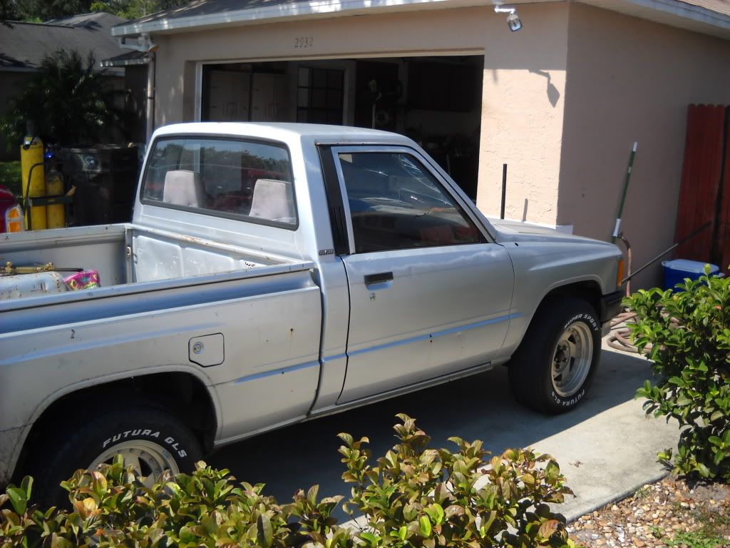

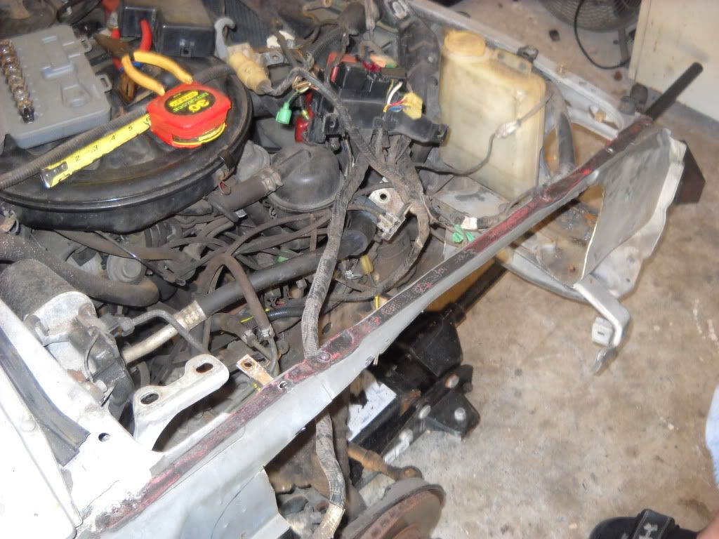

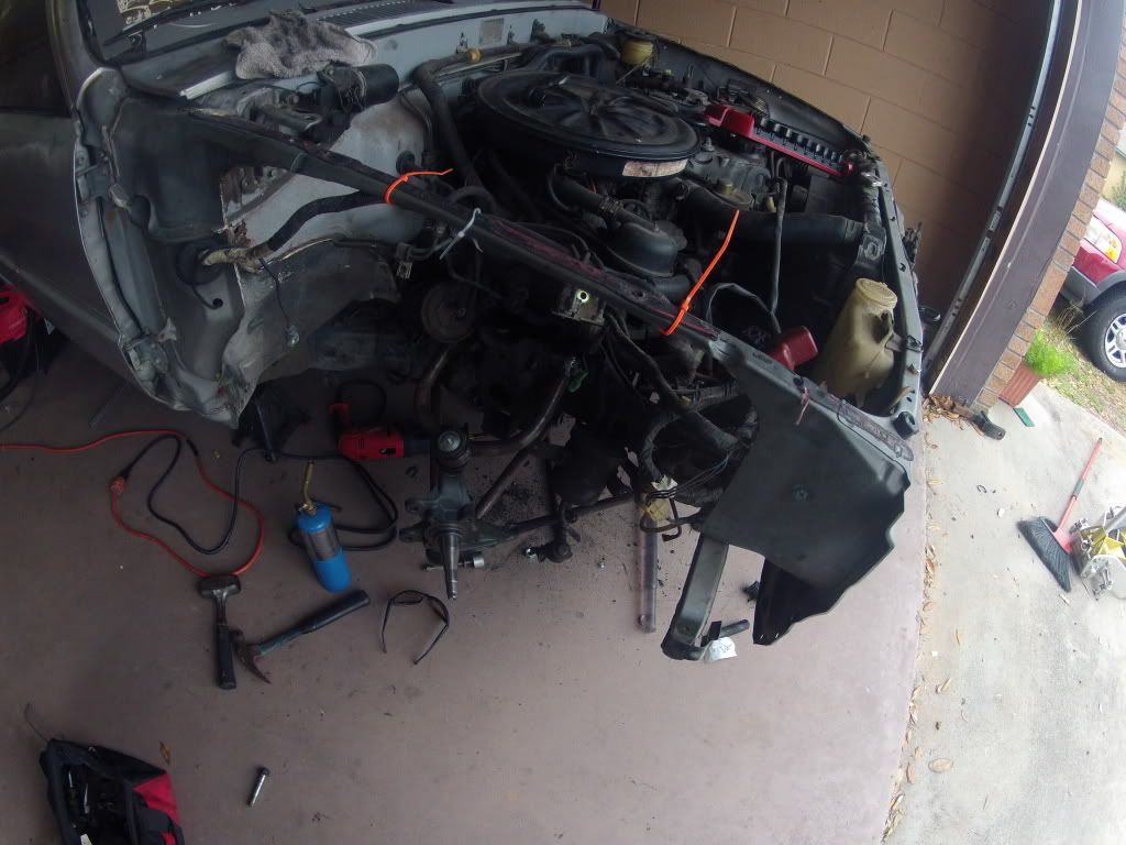

Here is the truck the first day i pulled it in the front yard to start stripping it down.
87 Toyota pickup DSCN0953
87 Toyota pickup DSCN0954
87 Toyota pickup DSCN0955

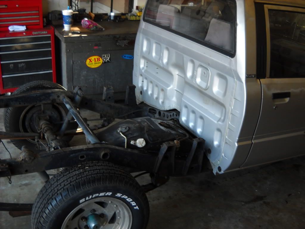

Snatched the bed off

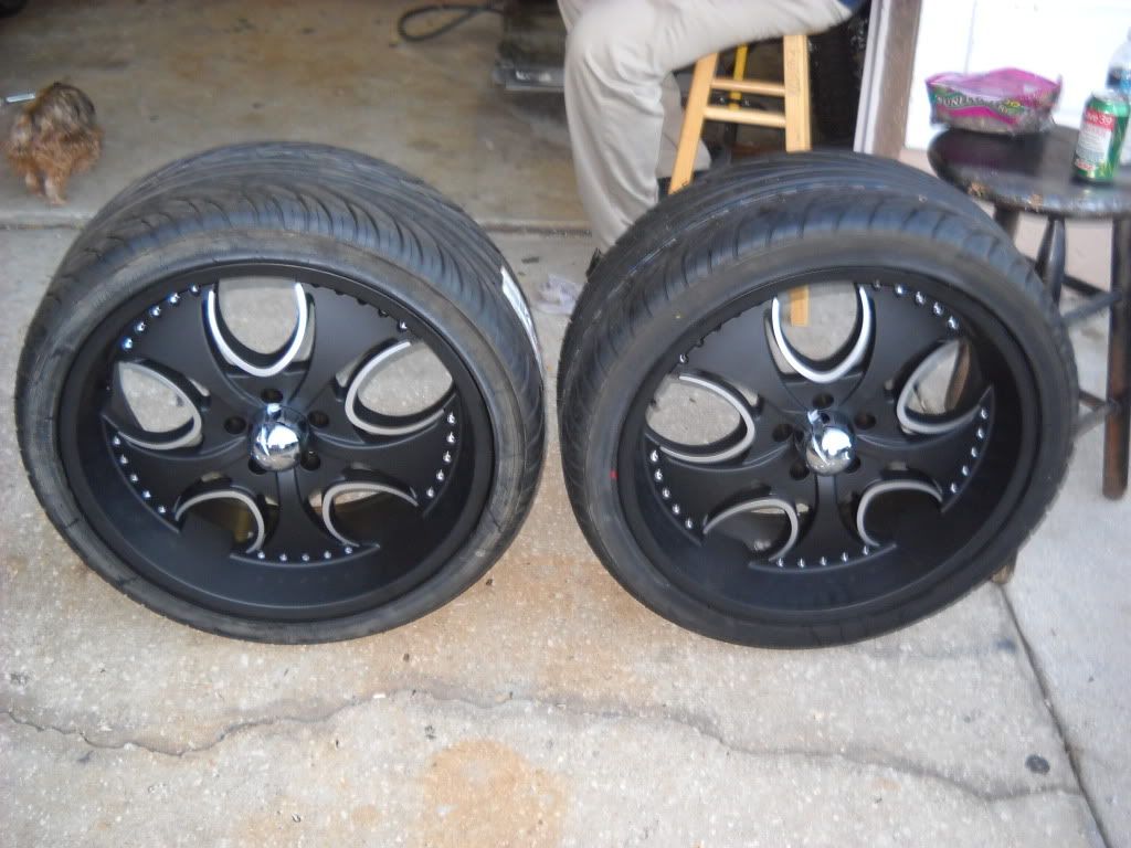

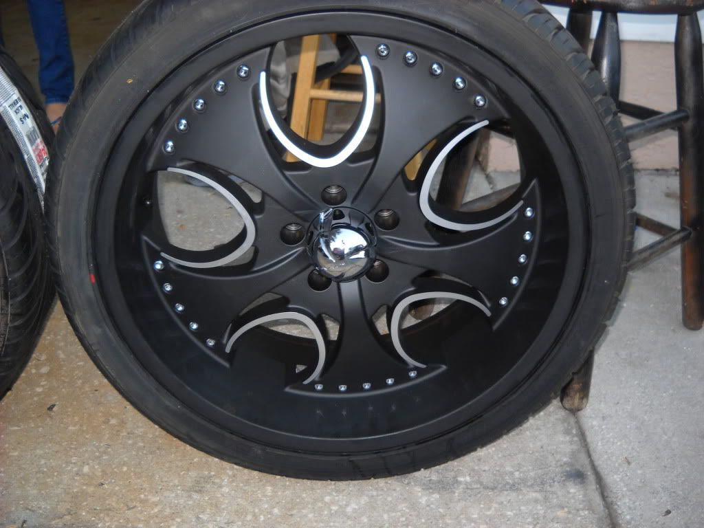

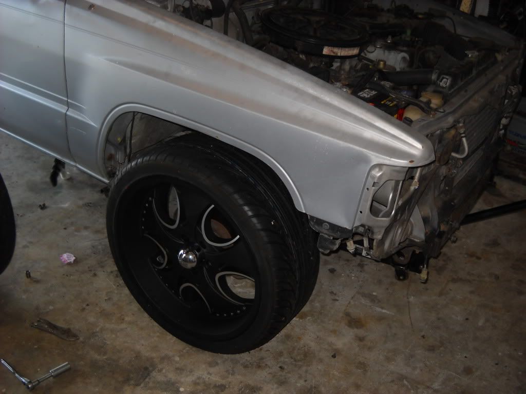

Bought the wheels before i started cutting and all that so im positive that they will fit.
87 Toyota pickup DSCN0981
87 Toyota pickup DSCN0980
87 Toyota pickup DSCN0984
KMC matte black Venoms 20"
Now ordering these wheels i knew they wouldnt tuck into the 2wd fenders, so it was no surprise

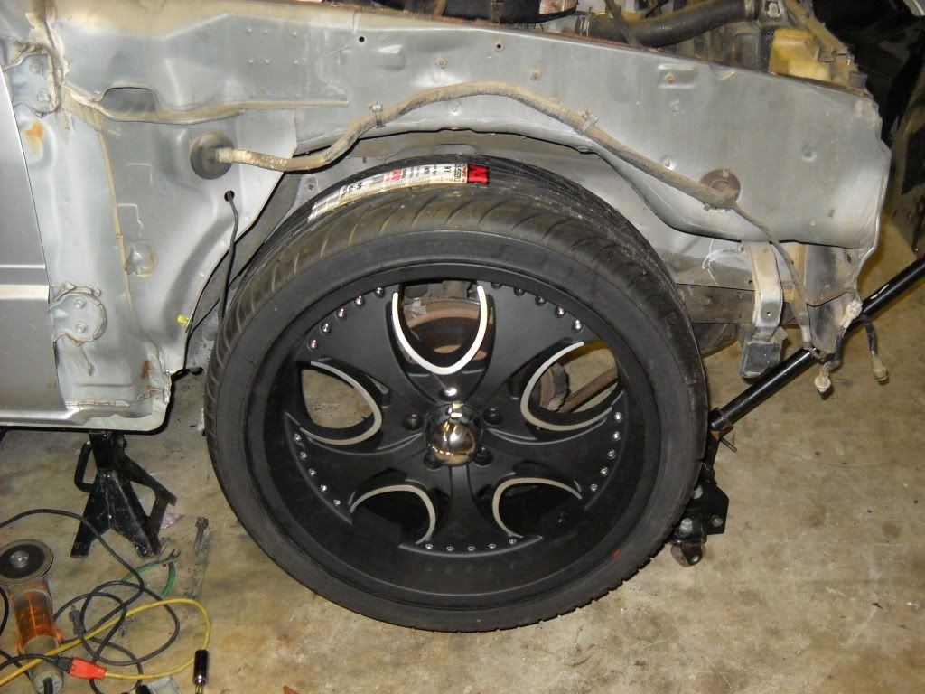

Hung them on to get an idea

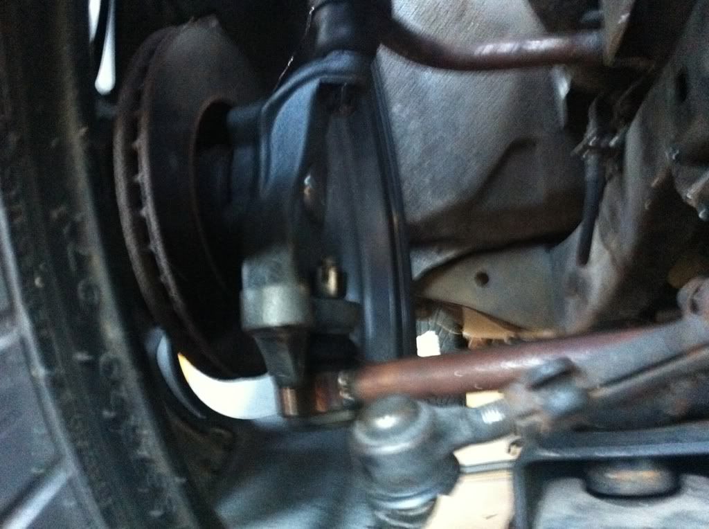

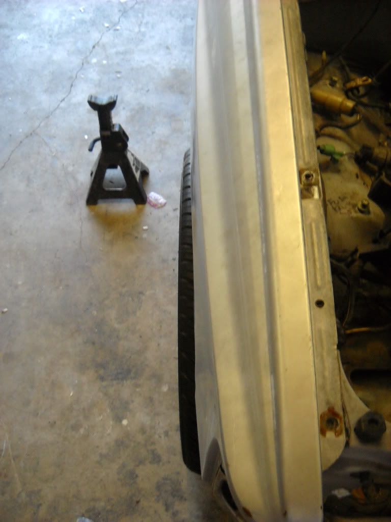

And jacked up the wheel... it tucked, sorta.
87 Toyota pickup DSCN1010
87 Toyota pickup DSCN1011

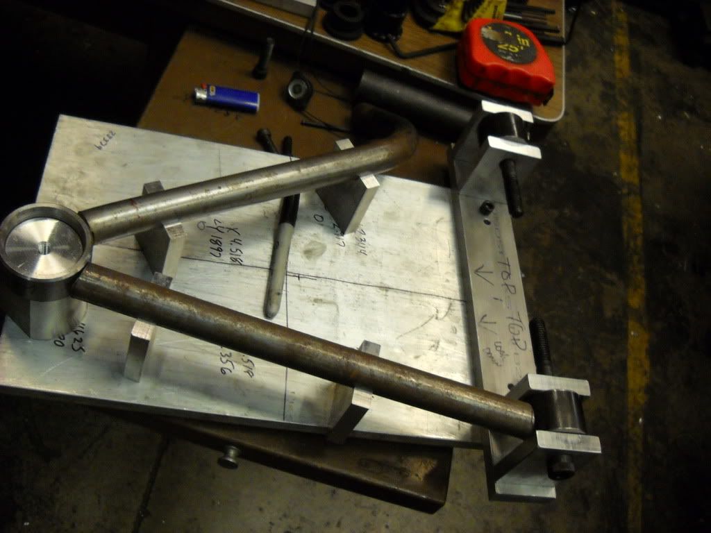

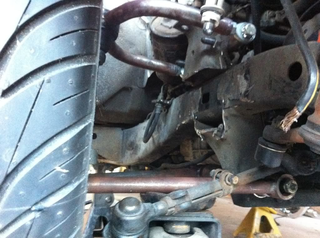

Didnt want to spend the money for CanDo control arms, so we built our own.
OEM lower
87 Toyota pickup DSCN1169

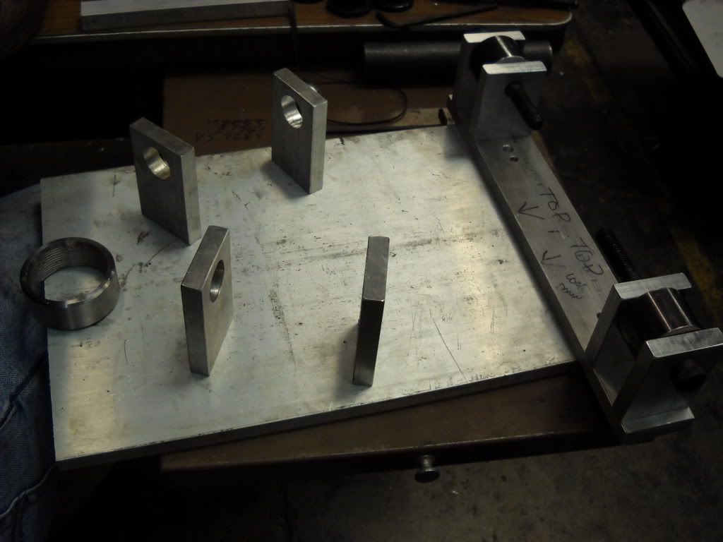

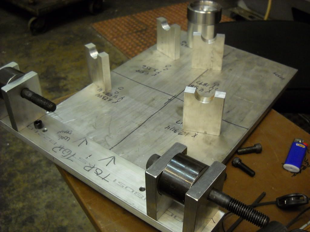

Sketch so we can make the jig
87 Toyota pickup DSCN1175
87 Toyota pickup DSCN1180
87 Toyota pickup DSCN1181
87 Toyota pickup 3ce18acc
87 Toyota pickup DSCN1178
87 Toyota pickup DSCN1182
87 Toyota pickup DSCN1183
87 Toyota pickup DSCN1186
87 Toyota pickup DSCN1187
87 Toyota pickup DSCN1188
87 Toyota pickup DSCN1189
Same base for the upper jig, just rebolted shit.

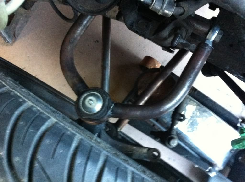

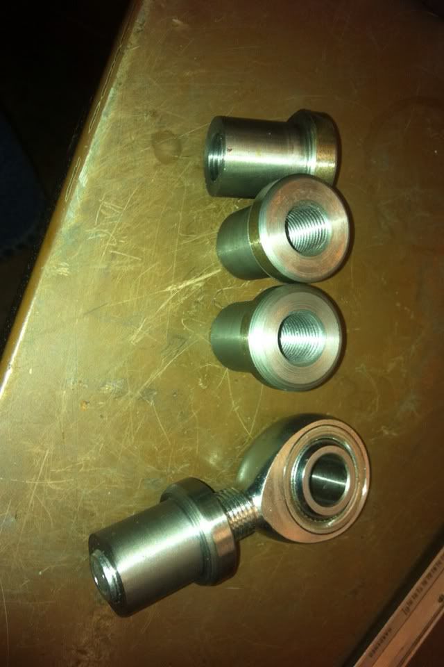

The heim joint
87 Toyota pickup 44763403
87 Toyota pickup 185d8220

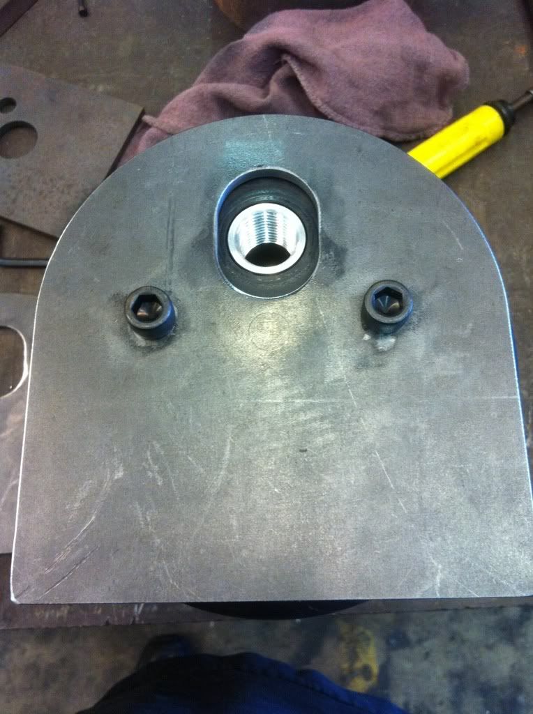

They'll screw into the little housing which will be welded to the uppers so they can be adjusted.

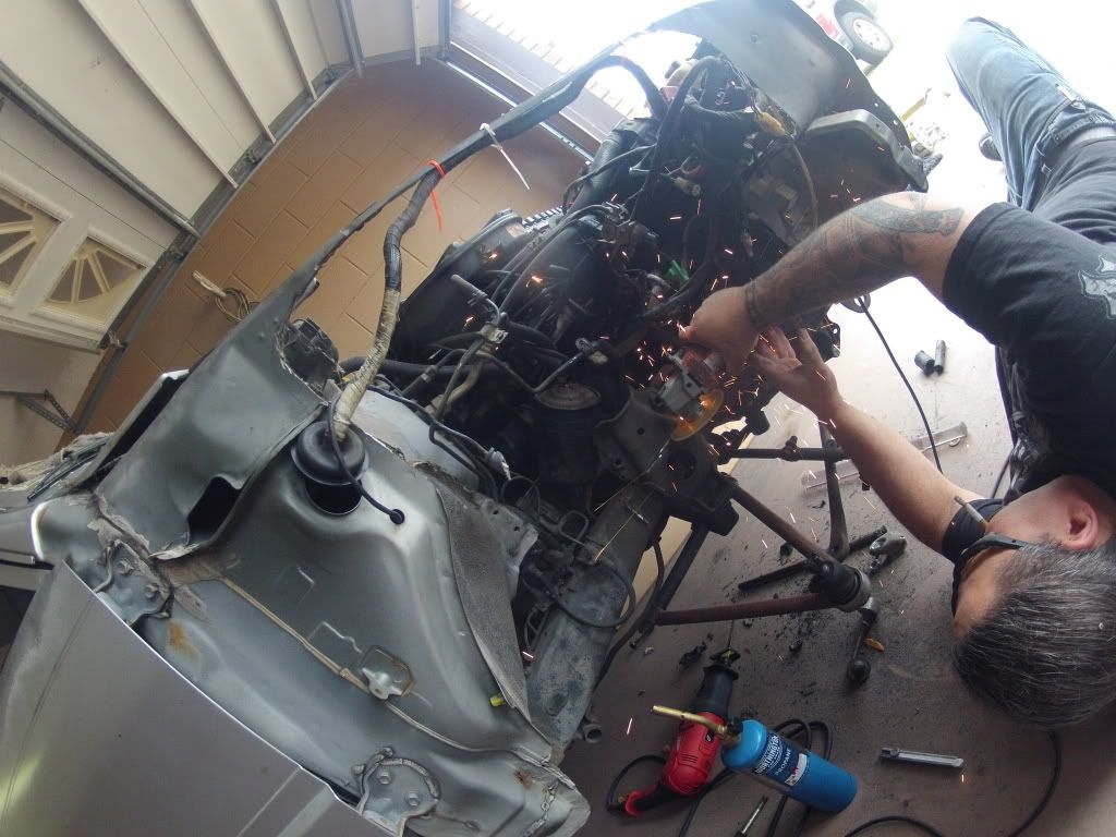

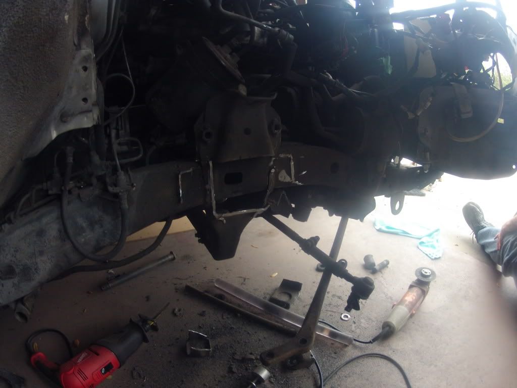

Post by POS-hardbody on Mon Feb 27, 2012 6:38 pm

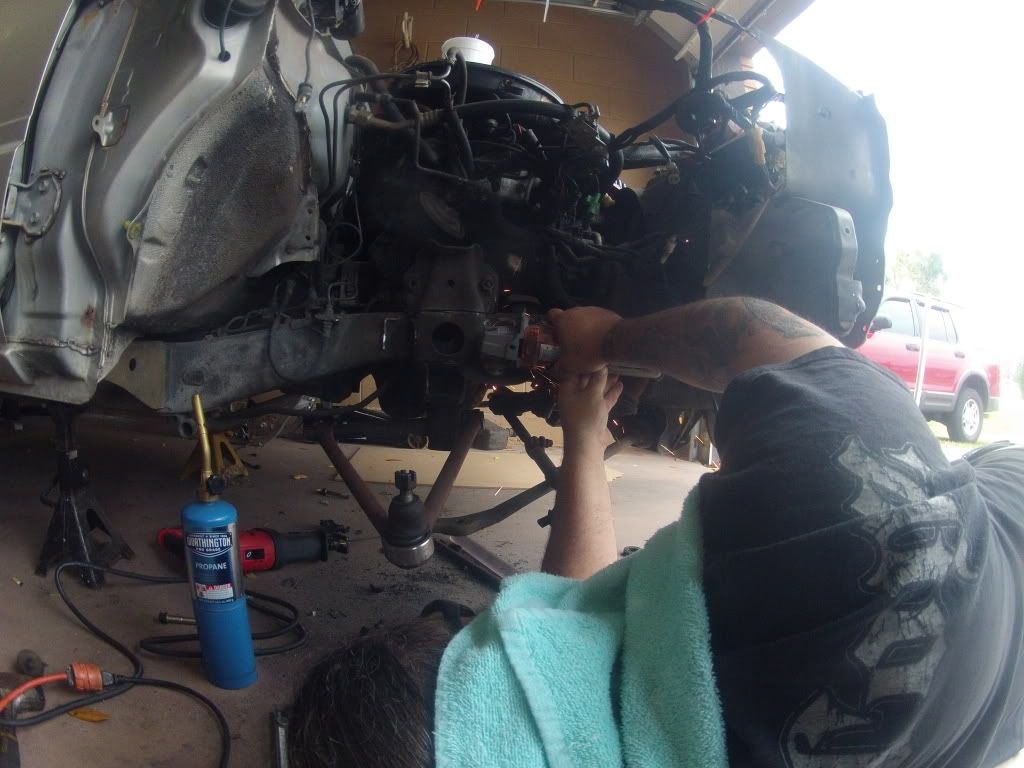

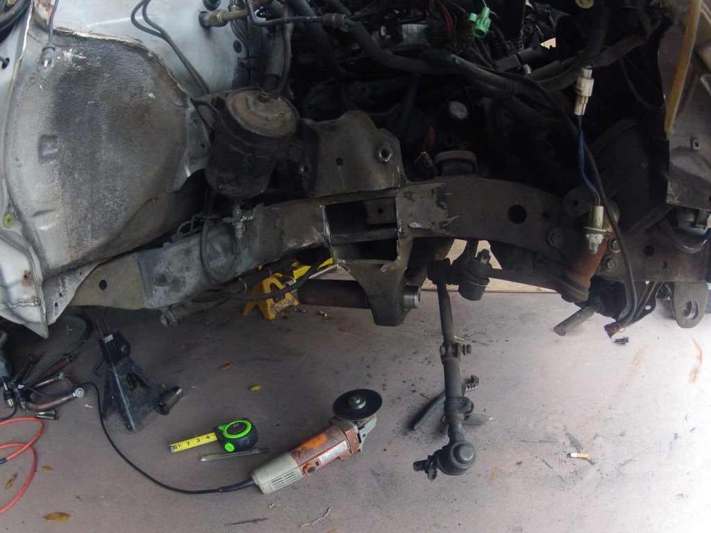

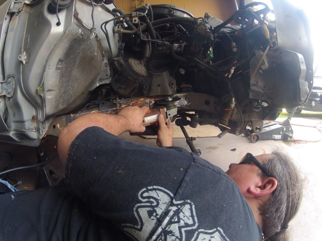

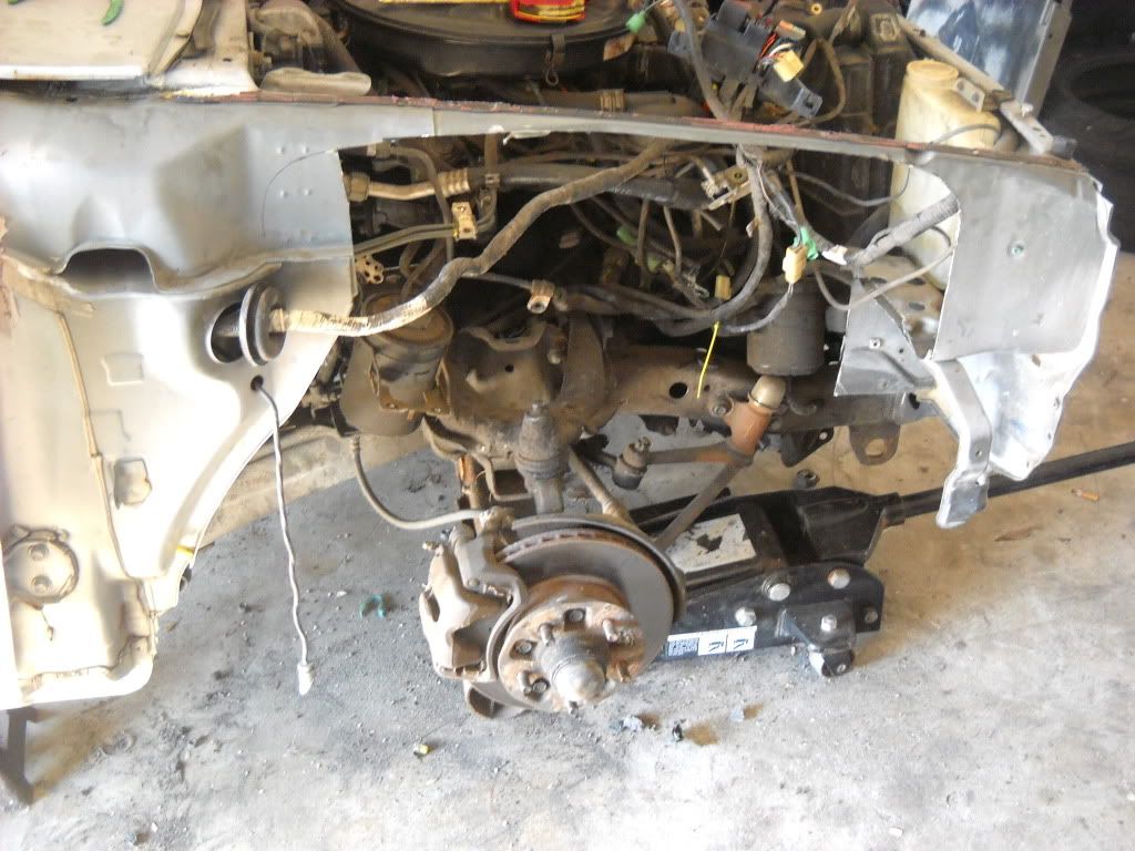

Alright alright, like i said earlier this morning i have some small update. As most of you know(some dont) i moved houses after i we got the trucks front end apart and it wasnt driveable. We had to settle into the new house and get into the groove of everything again, which took way too fucking long. So with that said... Weve been needing to get 220 put into the house for the welder to run, we have needed a new sawzal and a few other misc bullshit. Which we got just about everything. Still need to buy 3 sets of matching jack stands so everything is level and not a leaning and shit. Those should be bought by the end of this week. And tubing and metal materials will be picked up along the way. So with the new sawzal, a few cut off discs and grinding wheels, we got to removing all the factory suspension shit from the front passenger side(no reason for that side being first, just the side that the wheel well was cut out first so we just continued that side). Got all that out and then moved to the other side, snatched out the factory control arms and cut the wheel well out of that side. Small update i know but it'll get the ball rolling, also we got a pretty badass phone call from my dads friend last night so i should be having a surprise for you fuggers here soon. On with the pictures!!!!!!!

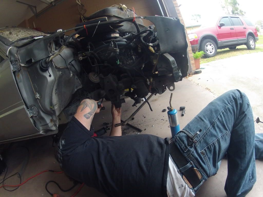

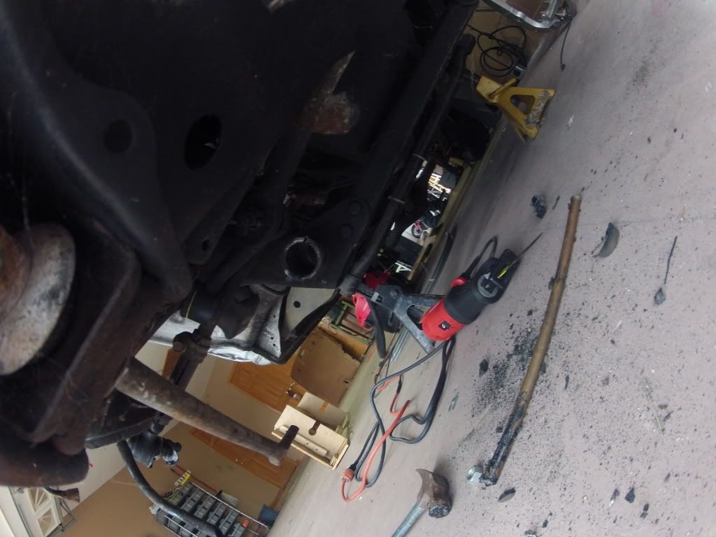

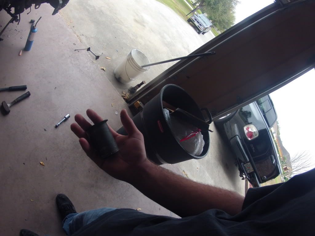

My dads big ass under there hammering out the bushing for the old lower.
87 Toyota pickup GOPR0121
87 Toyota pickup GOPR0120
Said bushing....
87 Toyota pickup GOPR0126

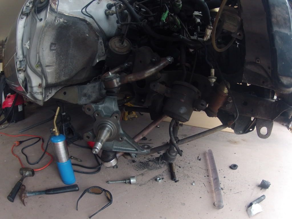

Quick mock up of the arms we made and the drop spindles before anything was all cut the fuck up.
87 Toyota pickup GOPR0129
87 Toyota pickup GOPR0130

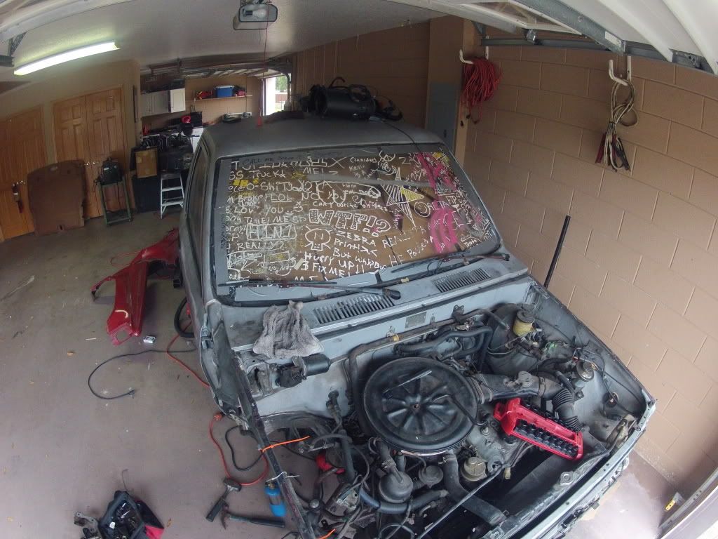

This is what happens to a truck left in my garage with a busted windsheild.
87 Toyota pickup GOPR0131

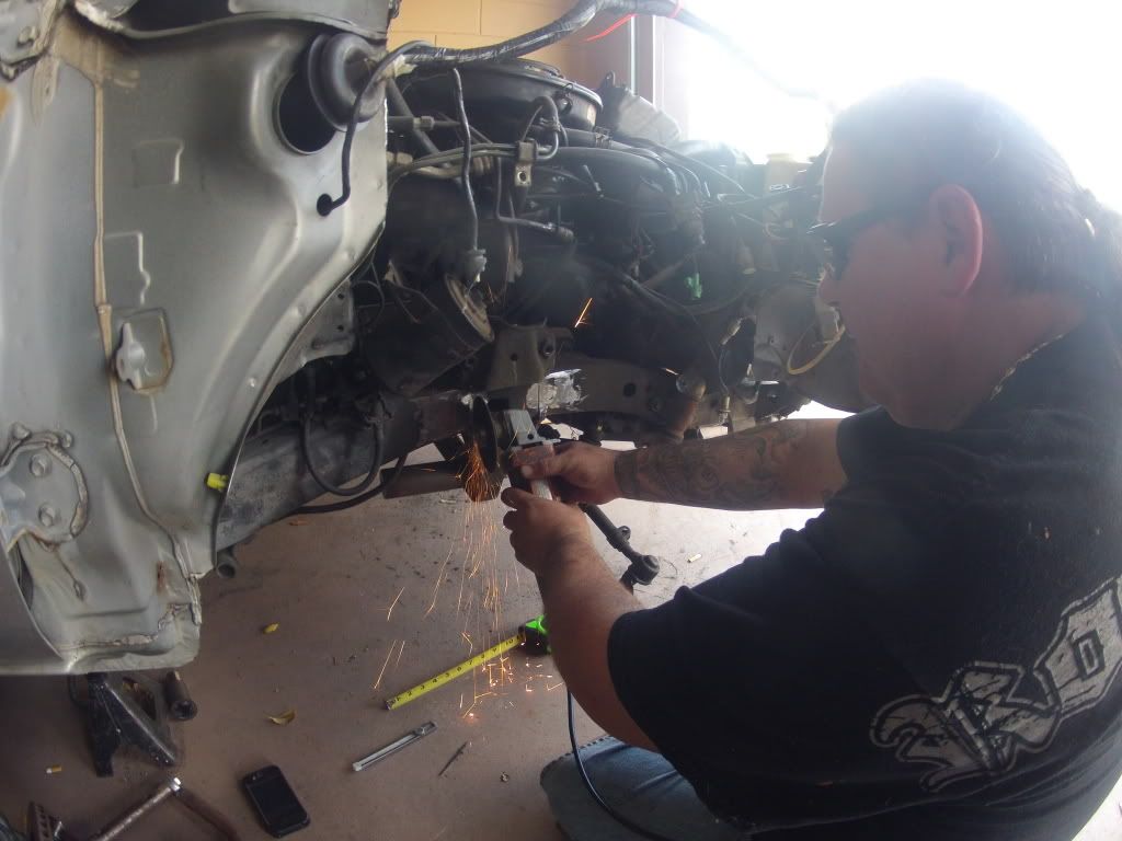

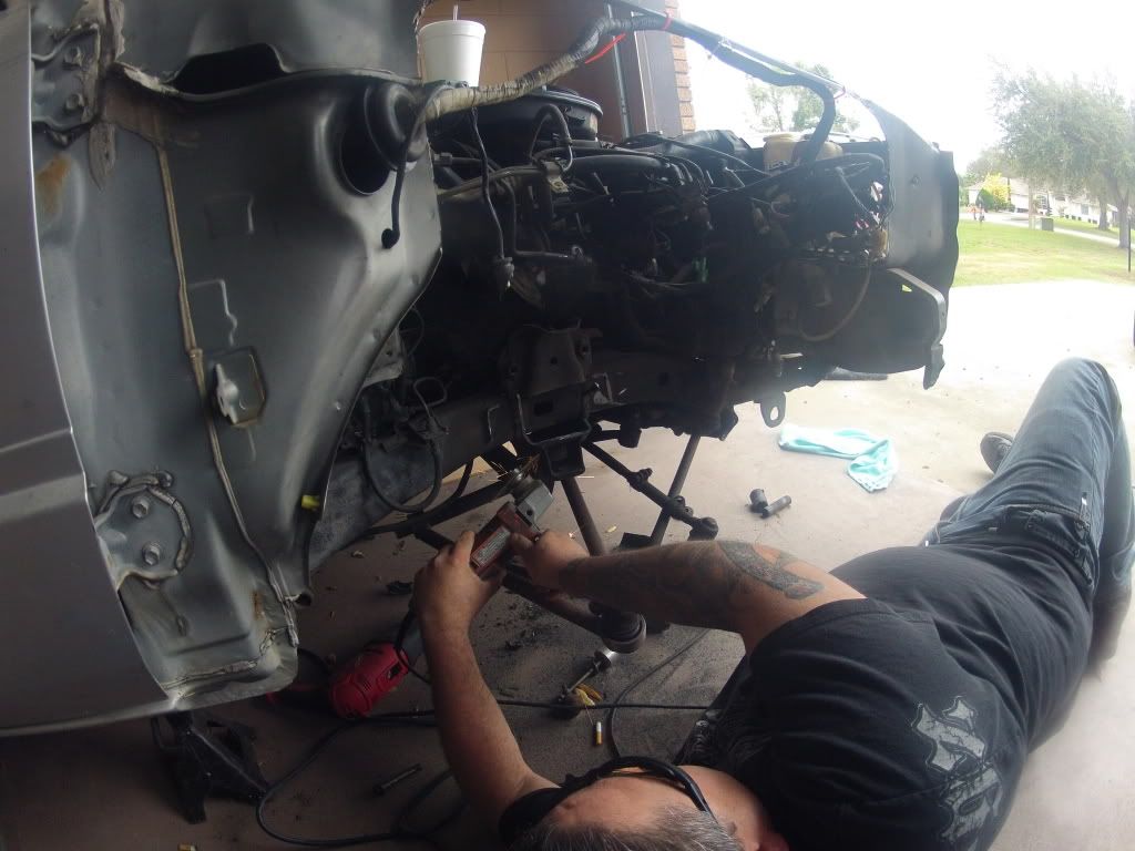

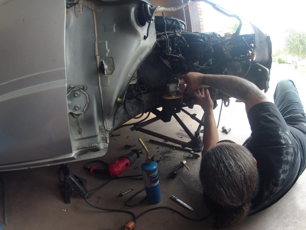

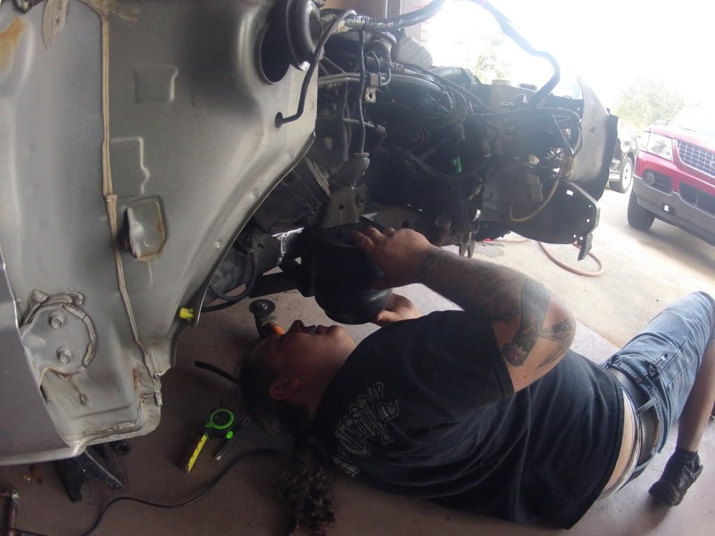

Fat man down there cuttin away at the old
87 Toyota pickup GOPR0157
87 Toyota pickup GOPR0159
87 Toyota pickup GOPR0165

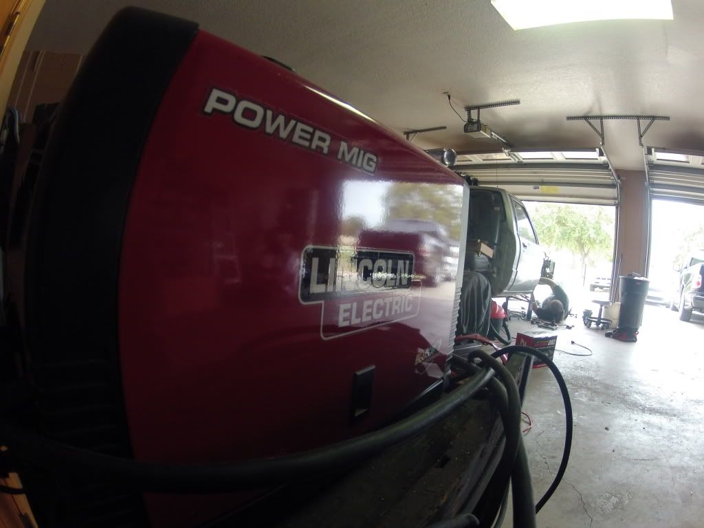

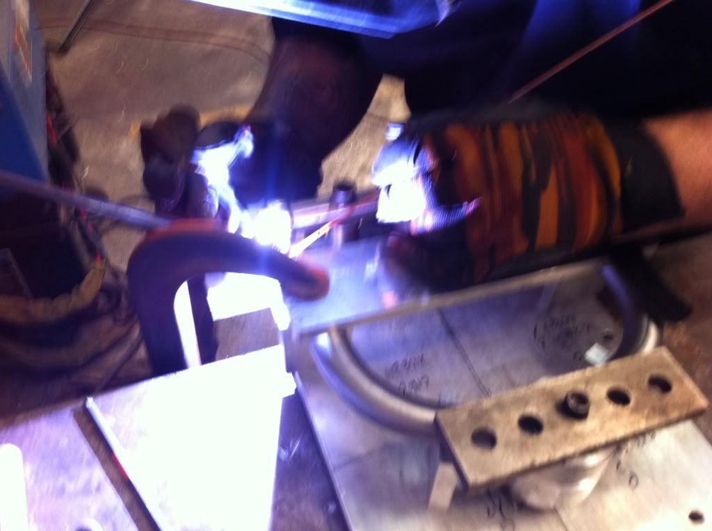

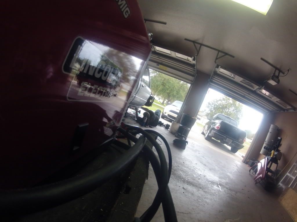

Sick ass picture of the welder, wouldve liked a Miller more but we found this one for a stupid low price. It works fuckin beastly.
87 Toyota pickup GOPR0166
87 Toyota pickup GOPR0187
I get side tracked....
87 Toyota pickup GOPR0179
Back to whatever the hell was goin on
87 Toyota pickup GOPR0186

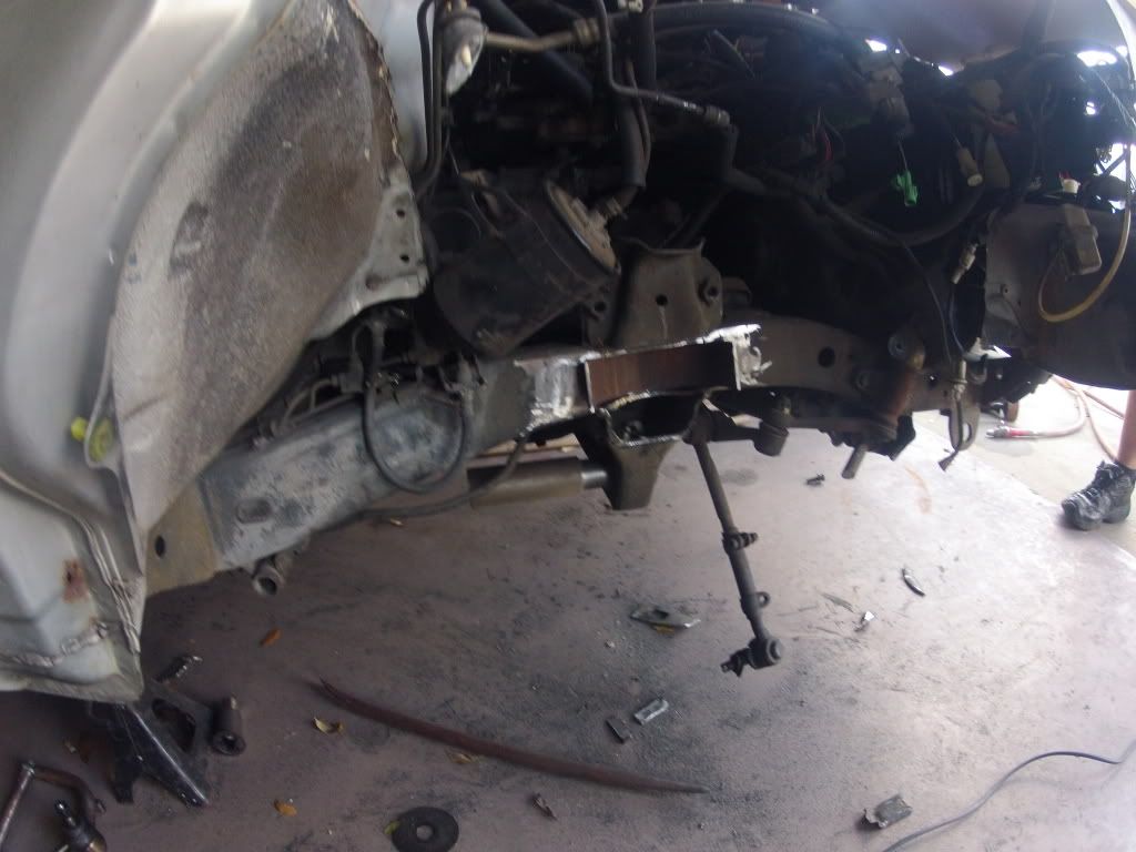

Most of it cut out
87 Toyota pickup GOPR0191
87 Toyota pickup GOPR0195
87 Toyota pickup GOPR0203

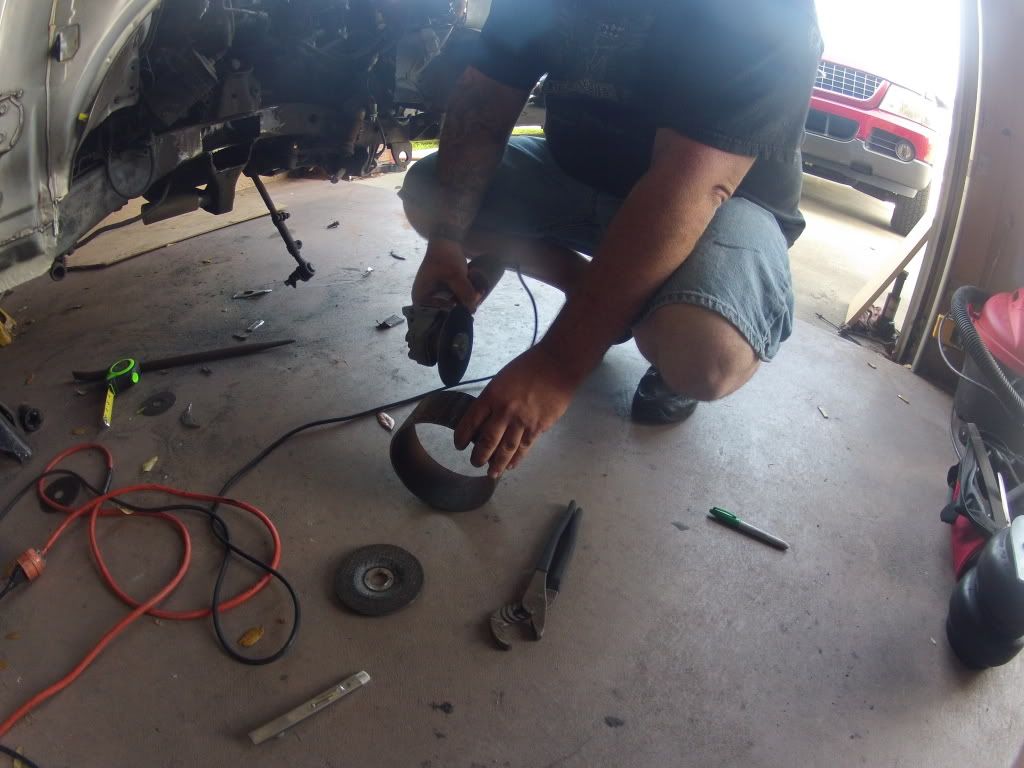

No pictures of the grinding away at shit cause i was doing the grinding.
THEN...
87 Toyota pickup GOPR0214
87 Toyota pickup Pbucket
So thats that shit! Simple update.

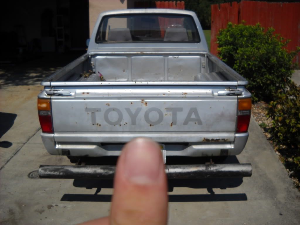

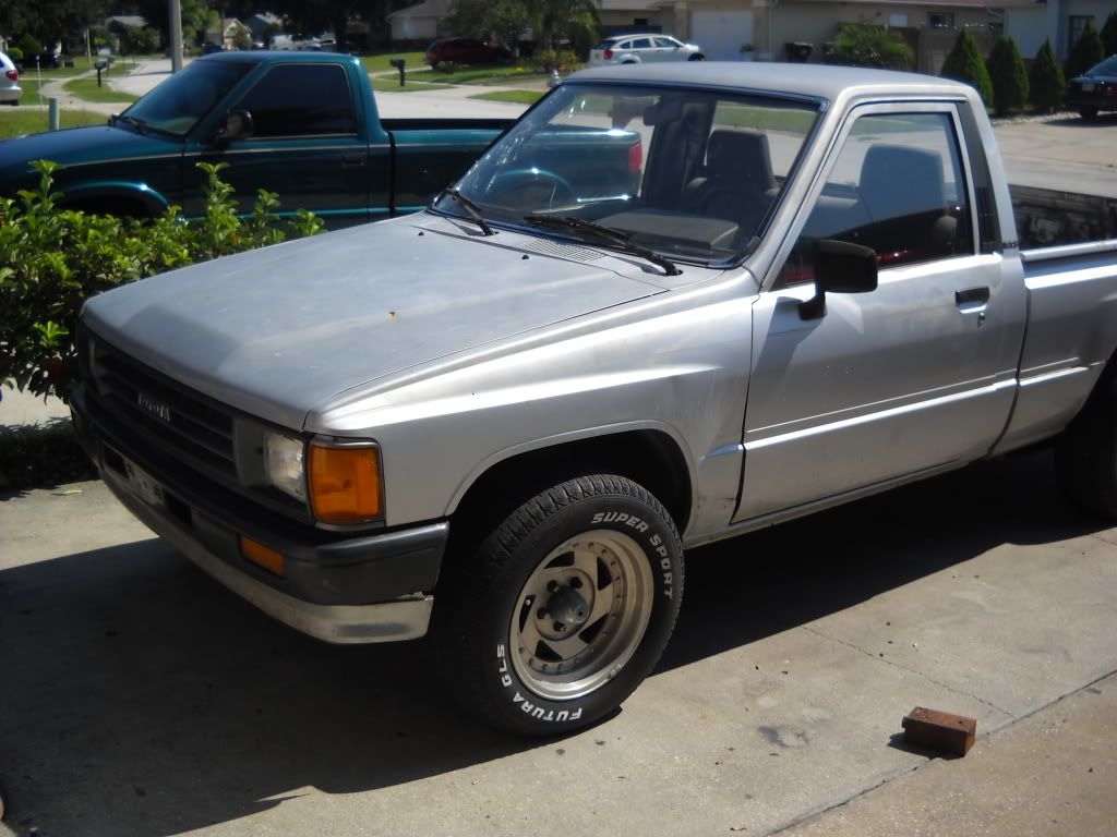

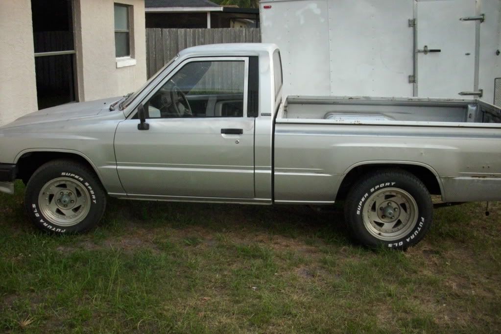

By the way, this is what it started off like...
87 Toyota pickup 115

Thanks brehs. Get used to the wide angled lense. Lovin this Gopro...
87 Toyota pickup Empty Re: 87 Toyota pickup
Post by Nickgeezee on Tue Feb 28, 2012 12:46 am
Lincoln>miller IMO there both good tho
Posts : 410
Age : 32
Post by POS-hardbody on Tue Feb 28, 2012 12:56 am
Ive just had more personal experience with a similar Miller mig welder, but the lincoln is without a doubt a beast

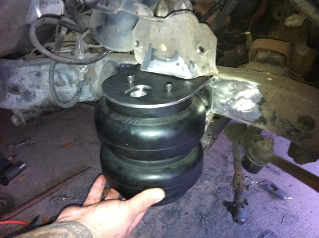

Post by POS-hardbody on Thu Mar 01, 2012 9:48 pm

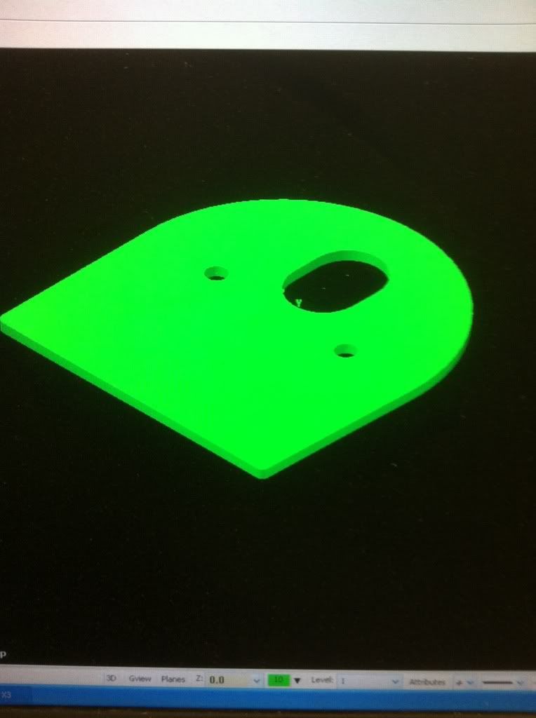

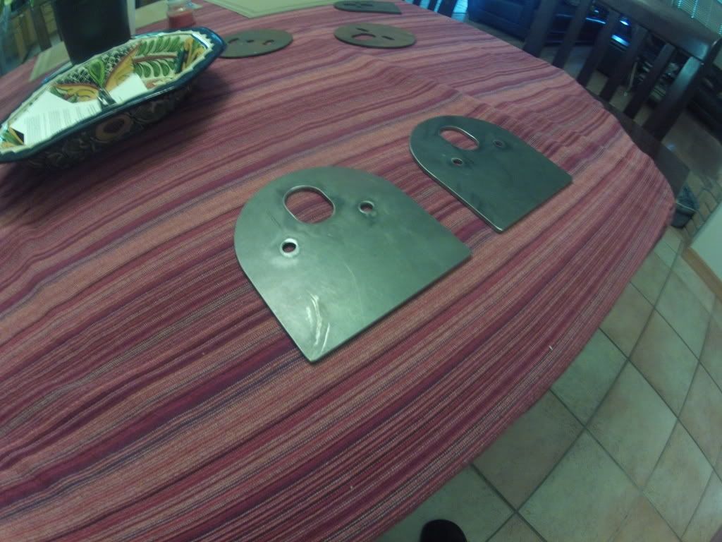

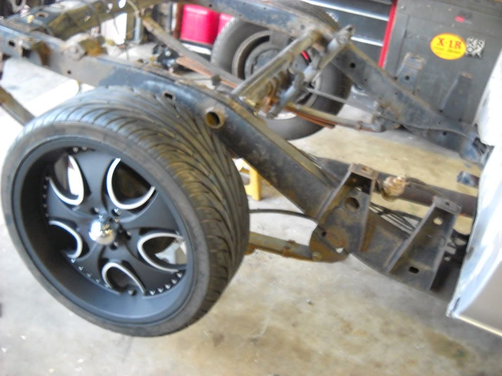

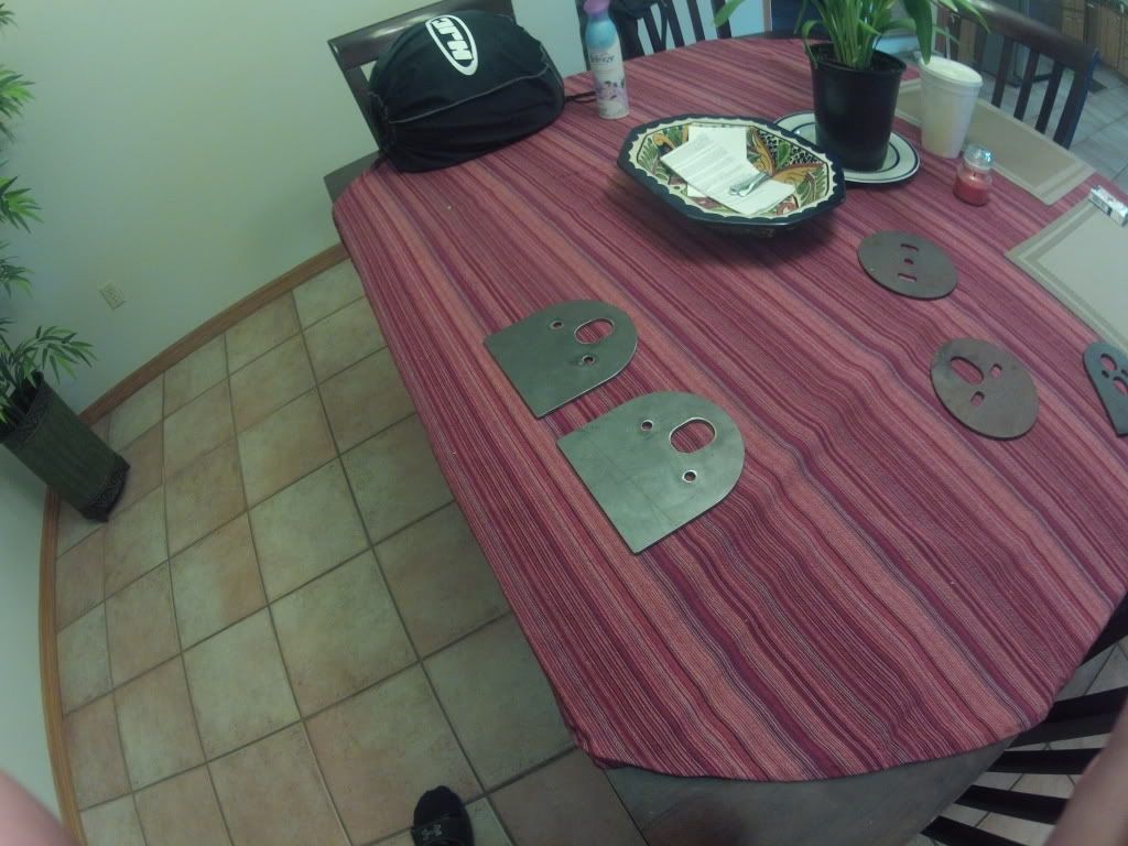

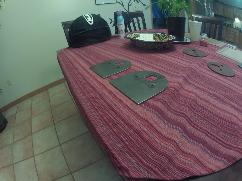

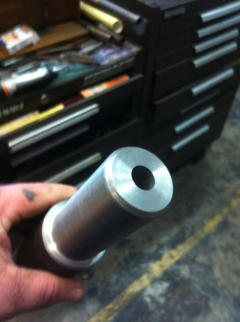

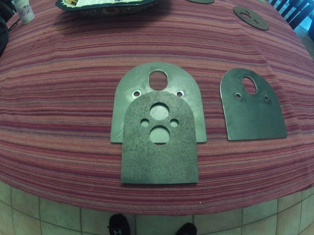

Alright, quick update... Got the "spacer" made up for the lowers, and we were able to mock everything up. Got the wheel mocked up and played around with it a little. Were going to have to tub the cab a little to get as low as we can with these 20's. Fuck it. Gotta do what you gotta do.
87 Toyota pickup 6dc628cf
87 Toyota pickup 155b73eb
87 Toyota pickup 5e8383b4
87 Toyota pickup 9a70710f
87 Toyota pickup 117eece6
87 Toyota pickup B8422411
87 Toyota pickup 8ecac086

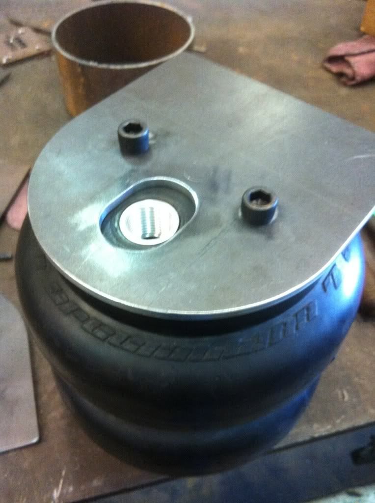

Since the bag brackets we had didnt fit right...
87 Toyota pickup Ae73d260
87 Toyota pickup 28f06a35
87 Toyota pickup C2850319
87 Toyota pickup E2744679
87 Toyota pickup GOPR0241
87 Toyota pickup GOPR0240
87 Toyota pickup GOPR0239
87 Toyota pickup GOPR0238

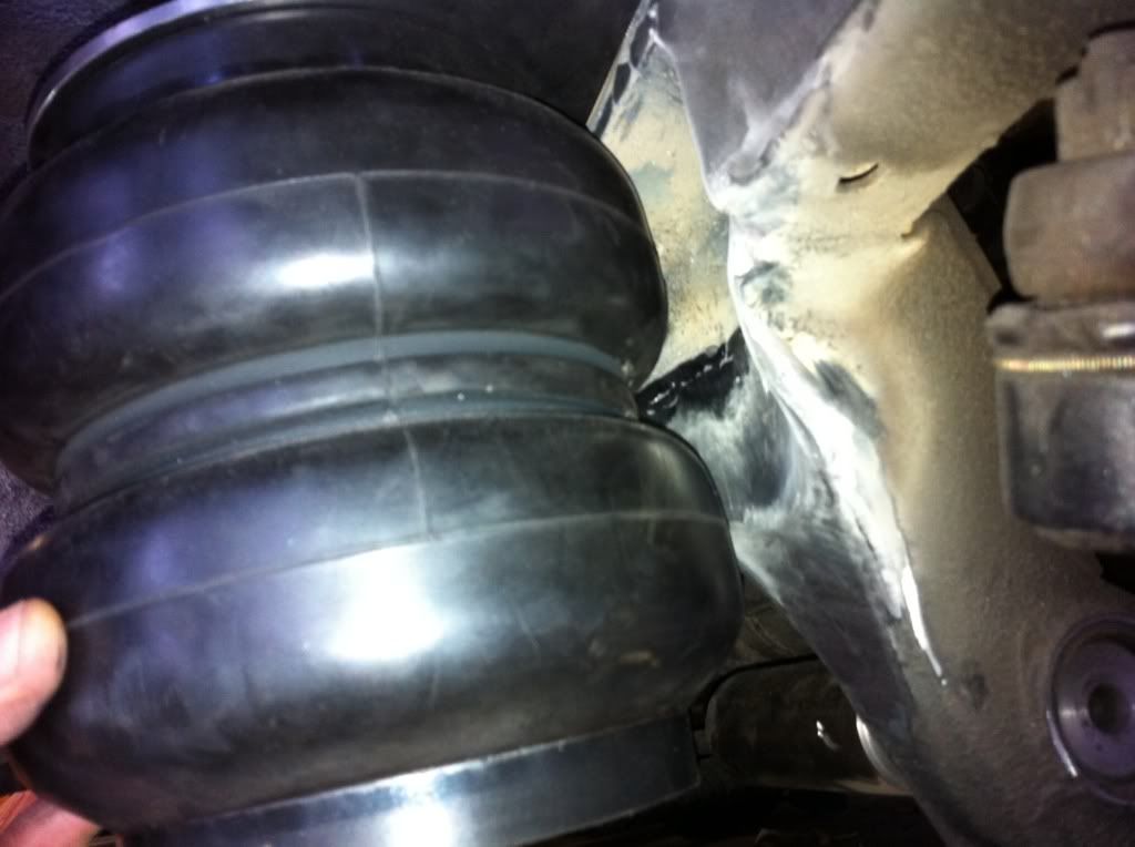

Still need to notch the front so the bag clears without problems. Then gotta cut out the passenger side shit and mirror the driver side.

Wait , you Has plasma/laser table ?
Are you going to notch the frame in the front for bag clear ? Dont think you have to I just see alot of ppl doing it that way now a days.
Post by POS-hardbody on Thu Mar 01, 2012 11:12 pm
No plasma table here. The pops owns a Haas VF1, over where he works. So he cut'em out in that. And yea we're defininetly going to have to notch the front of the frame for the bag. It wont clear without it.

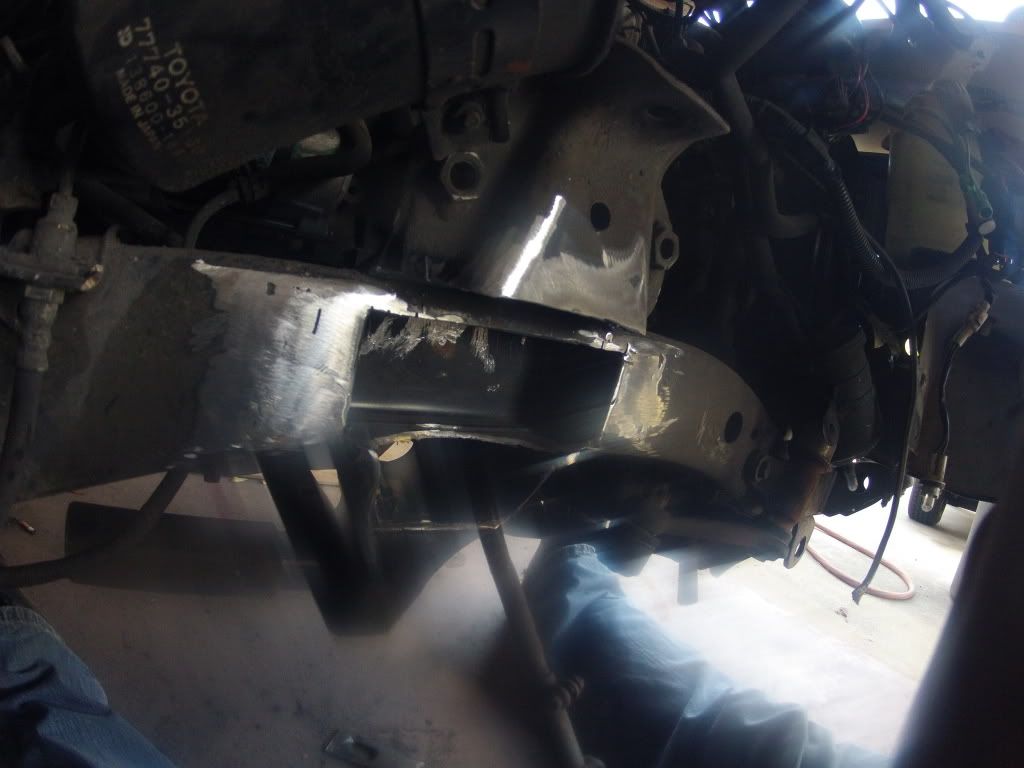

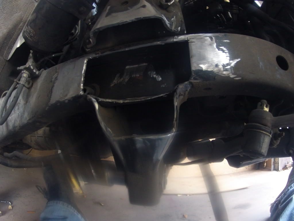

Post by POS-hardbody on Sun Mar 04, 2012 11:11 am

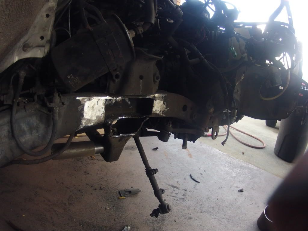

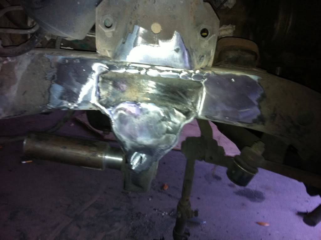

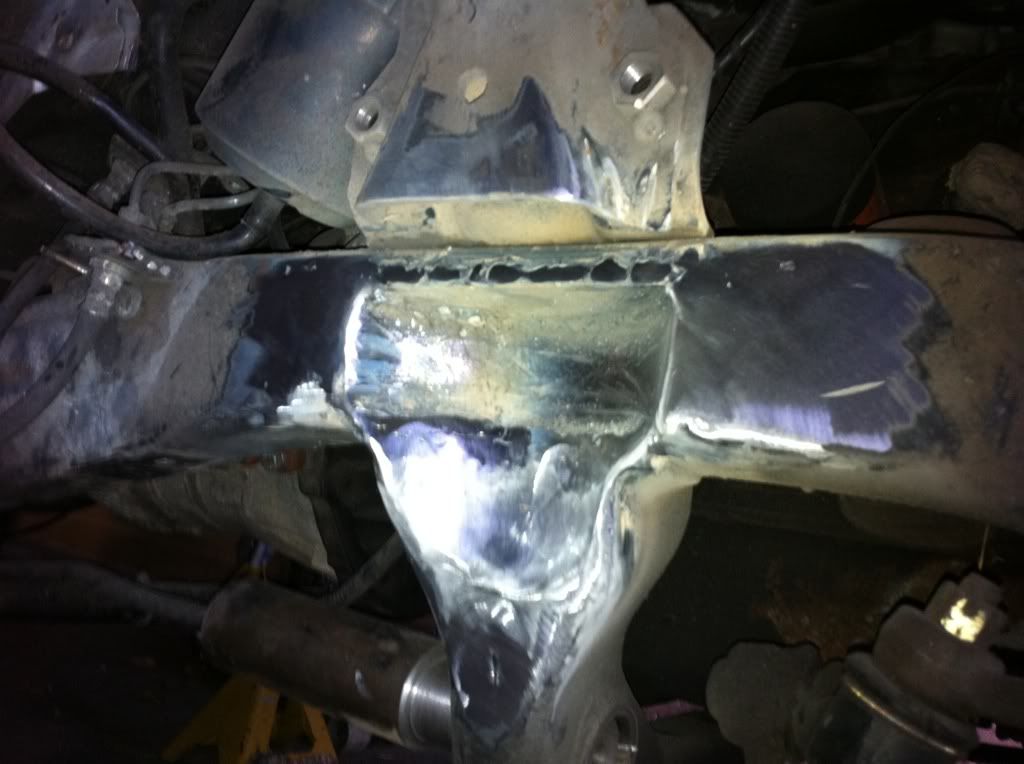

Yesterday was the start of boxing the driver side frame for the bag to clear. Here we go... Got fat man down there cuttin shit.
87 Toyota pickup GOPR0245
87 Toyota pickup GOPR0247
But once we got that peice of metal out of there, we found this little fucker hiding back there.
87 Toyota pickup GOPR0250
Not sure what it was, but its gone now...
87 Toyota pickup GOPR0266
Then checking whatelse needs to go.
87 Toyota pickup GOPR0257
THIS PIPE!
87 Toyota pickup GOPR0272
87 Toyota pickup GOPR0276

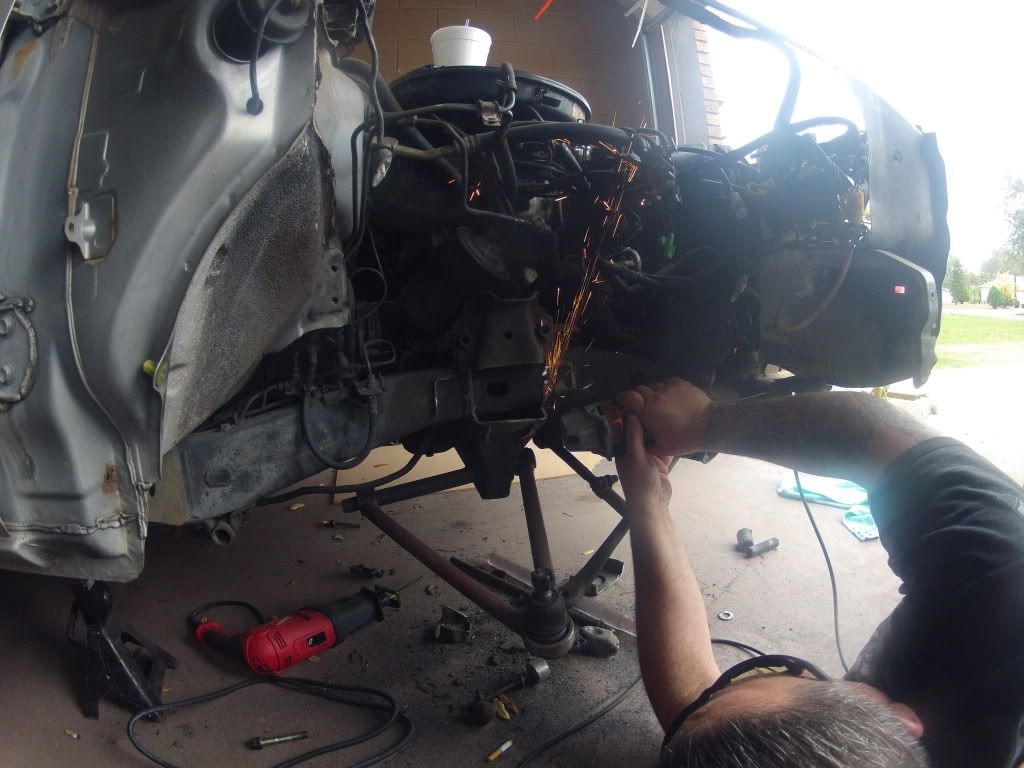

Cleanup for some welds... And apparently some shit got on the lense.
87 Toyota pickup GOPR0280
87 Toyota pickup GOPR0281

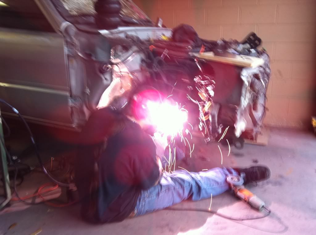

Battery on the GoPro died, and got annoyed of watching so i got to welding.
87 Toyota pickup 5545f0d9
Finished product. Didnt get a picture of it, but under the section we put the pipe in, we had to get a little radius on a flat sheet of steel then tack it, and hammer it to get shape. Which worked pretty fuckin good.
87 Toyota pickup 1008fb87
87 Toyota pickup 05da8103
DA CLEARENCE!
87 Toyota pickup 861a804b
87 Toyota pickup Beb0f22c
Now just have to weld the bracket in, finish the bracket on the lowers and mirror it on the other side and front will be done.
